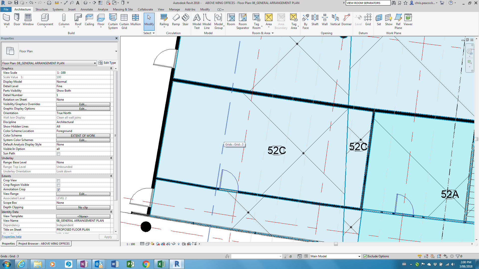

Hi I need to alter a revit model prepared by someone else who is not with us.
I have a space that has been divided into two, for graphic purposes. I assume it is a room separator. I can see the boundaries of the two rooms, bounded by walls and then by this diagonal line.
My problem is, that I do not know how to pick on this line. Delete it or modify it. I want one room bounded by walls only.

I've the solution to my problem.
Room separators need to made visible under Visibility graphics "lines" expanded tab. I was looking under "Rooms".
