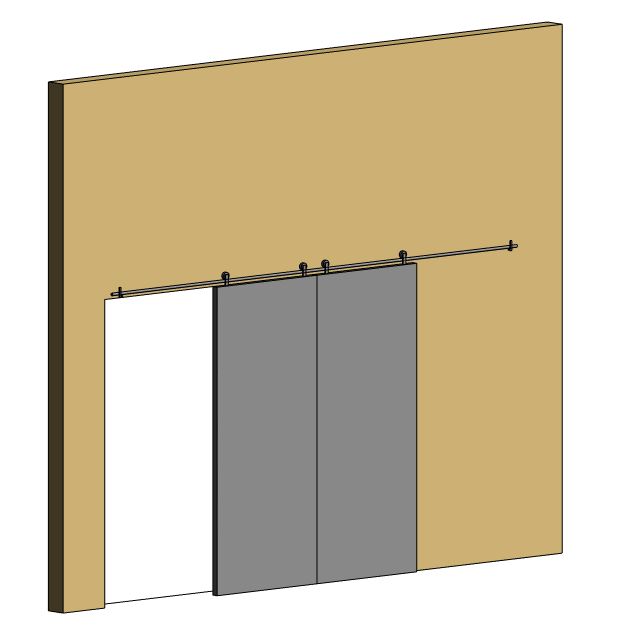

Revit 2017 - I have a barn door attached. I need to keep every thing as is but have the rough opening to be double the size of the door. That way as the doors moves 50% of the rough opening is always closed. Anyone know if this can be changed and how. - Thanks Byron

Select the opening and modify it.

I have tried that Please explain - Thank you Byron

Tab through to pick the opening, not the wall.
However, look at your parameters - you are forcing the door to be the same width as the opening.  Use the default opening - this is a family parameter, which has already been set into the template.  Control the width of the door panels based on this - eg door panel width is 1/4 of the total (opening) width.

Got it - Thanks Byron
