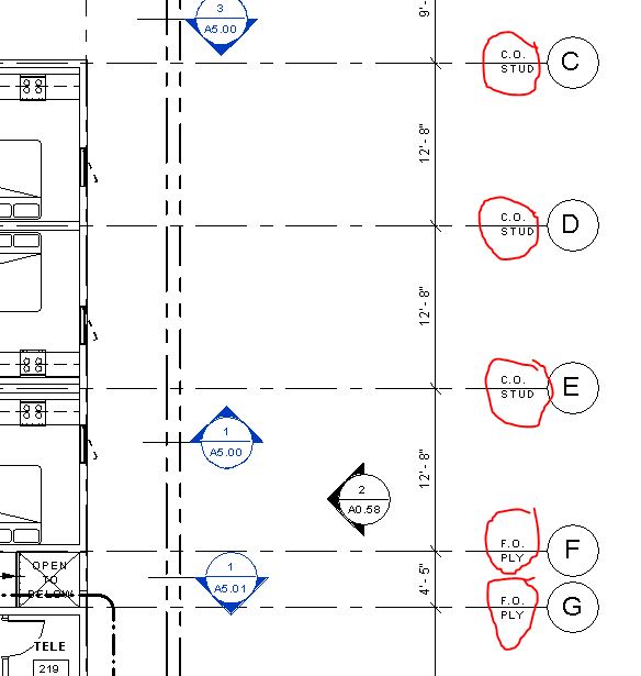

I am looking to add a instance based text to my grid lines so that when I move my grid lines, the corresponding text will follow. Or if I create a new view, I can turn on and off this text. In the attached image, the text in question is circled in red.   My only solution right now, is to create independent grid bubble families with different texts.  Is there a way to do this using only one grid bubble family?

I don't know how possible that is, but I think what you would have to do is go into the family, create an instance label where you want it to go, and then edit it for all of your grid lines. I did something very similar when I created some of the legends for my office. It takes a little bit of trial and error.
