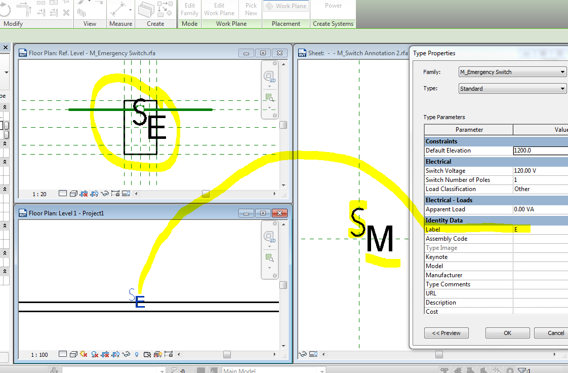

I'll point out first that sometimes what appears to be text is really just symbol lines assembled to appear like text as in the 'S' in the attached image. It's really just two arcs. The other peice of text that is variable when inserted into a project is a 'Label' that is also part of the nested Generic Annotation Family. All of these elements can be turned on or off by applying a Yes / No parameter to the Visibility property.
Hope this helps. Insert and open up the REVIT electrical family 'Emergency Switch' to see a sample.
