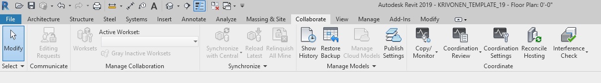

I want to make my Revit 19 Projects cental models, and in order to do that in the past i have had to click the "Collaberate" button next to the "Worksets" button on the Collaborate tab. However it apears I do not have the "Collaberate" button anywhere. (see attached picture)
Has anyone ran into this problem, or is there a new way to make a project a central model?
Thank you for your time.

So i was trying some different things and came across the Revit Update "Revit 2019.0.1". Once i installed that and re opened my Revit the button appeared! Ive posted the link to the update below.
https://manage.autodesk.com/cep/?&_ga=2.211932692.1231540877.1529438253-872467773.1516719378#products-services/updates
