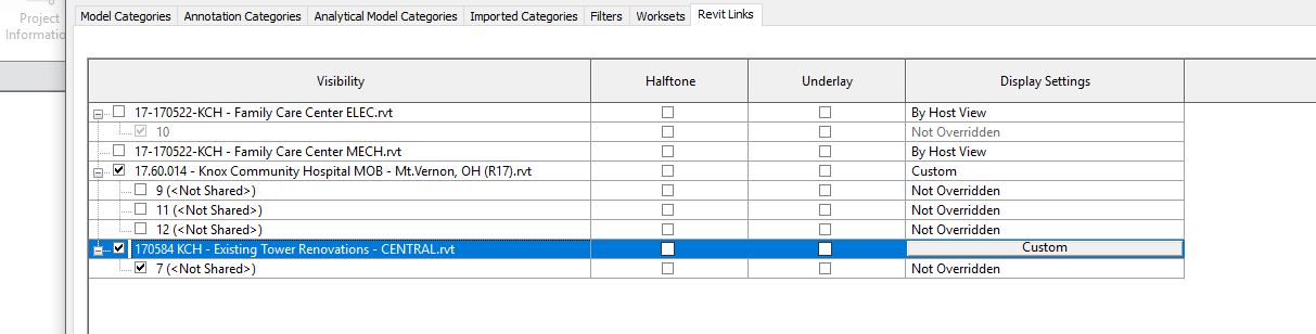

Can anyone tell me what these sub sets are, they were not there before and now they are starting to show uip. Trying to find out if someone is adding them by accident.
Tue, Jun 19, 2018 at 9:31:39 AM | SUB SETS UNDER A LINKED MODEL
The top most line is the Revit linked file.  The subset below this represent each instances of the linked revit file within your host file.
