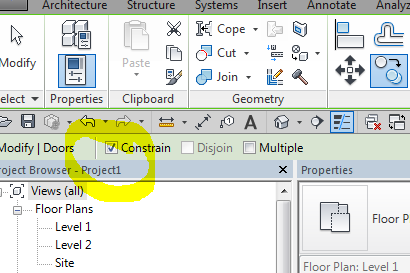

I have read all the threads about turning of ortho on a move or copy. I was playing around with keys and some how now when I move or copy aan object ir only moves in ortho. This requires me to move it twice to get to the location I want. I know I can hold down the shift key but I didn't have to do this before I started messing with the keys. Can some one help me to turn off the ortho in move or copy? - Thanks Byron

It's called 'Constrain'. Turn it on and off. It's not your ortho.
