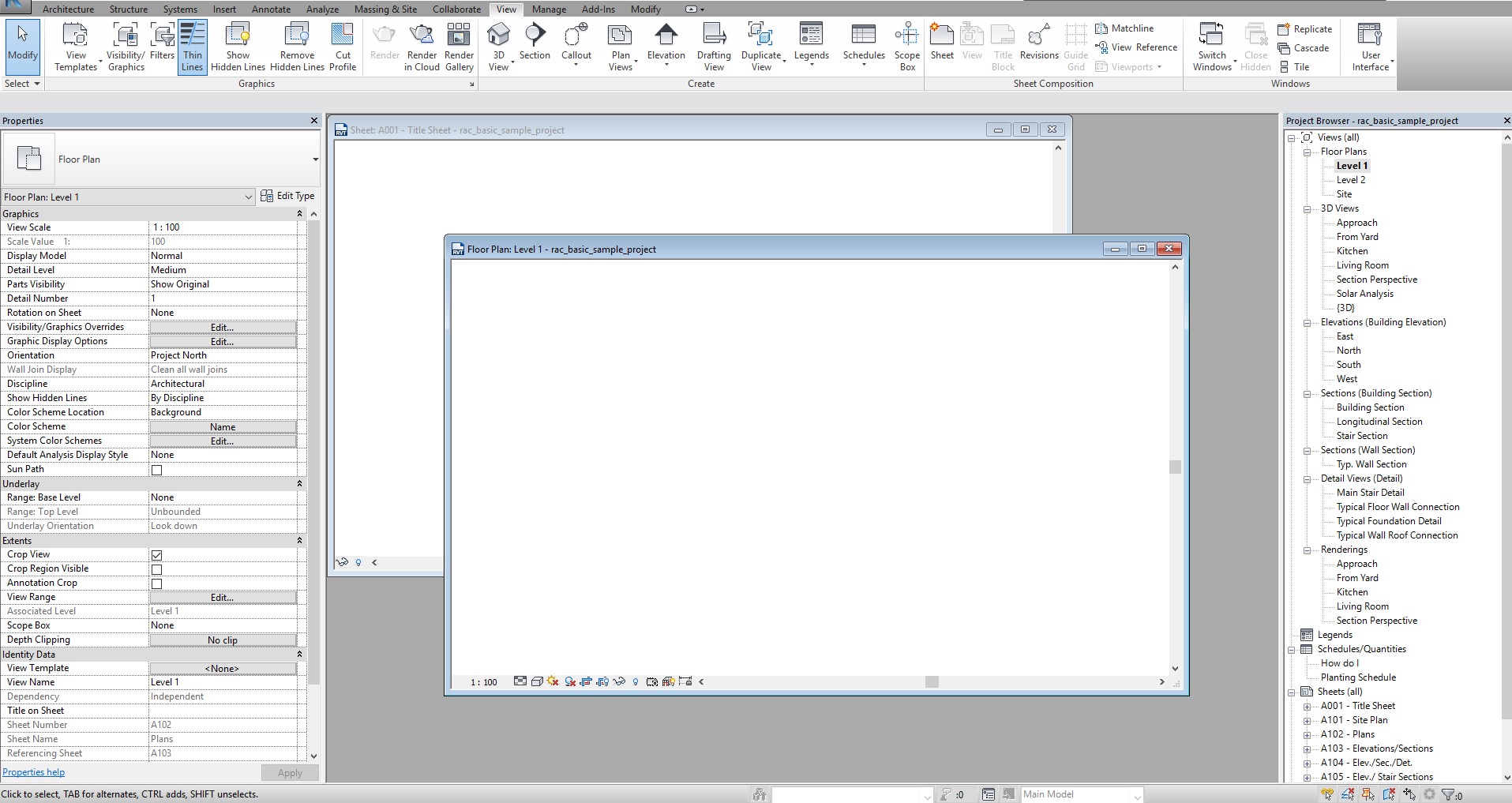

Hi all, I am having a huge issue with Revit at the moment. When I try to open a file it just shows up as blank. I cant see anythig at all and I am also unable to move around the project. I have tried a few different files and it just seems as though the tile/ window refuses to load the project or file. Im sure its something simple.
Thanks all.
Sun, Jun 10, 2018 at 4:15:19 PM | Revit tile/ window is blank
A little background on this file would help.
It looks like it is the standard, sample project which should be just fine unless someone was in it and changed some things around.  If this is what happened, it may be simply that the view is zoomed out too far or everything is turned off.
A typical za for zoom extends would show the complete project....but you may still not see anything because a model element is so far off in space that the view is too big.  To check for this, do a window selelection which is as big as the screen.  If you have one flag in the corner and everything else isbasically in another corner, you can zw (zoom window ) around the offeding culpret and then you can see what it is and dlete it.  Now a za will show the project.
Another issue is what might be turned off in the view.  While in the view, VG will show you what is on/off.... it may be set for all model elements to be off.
