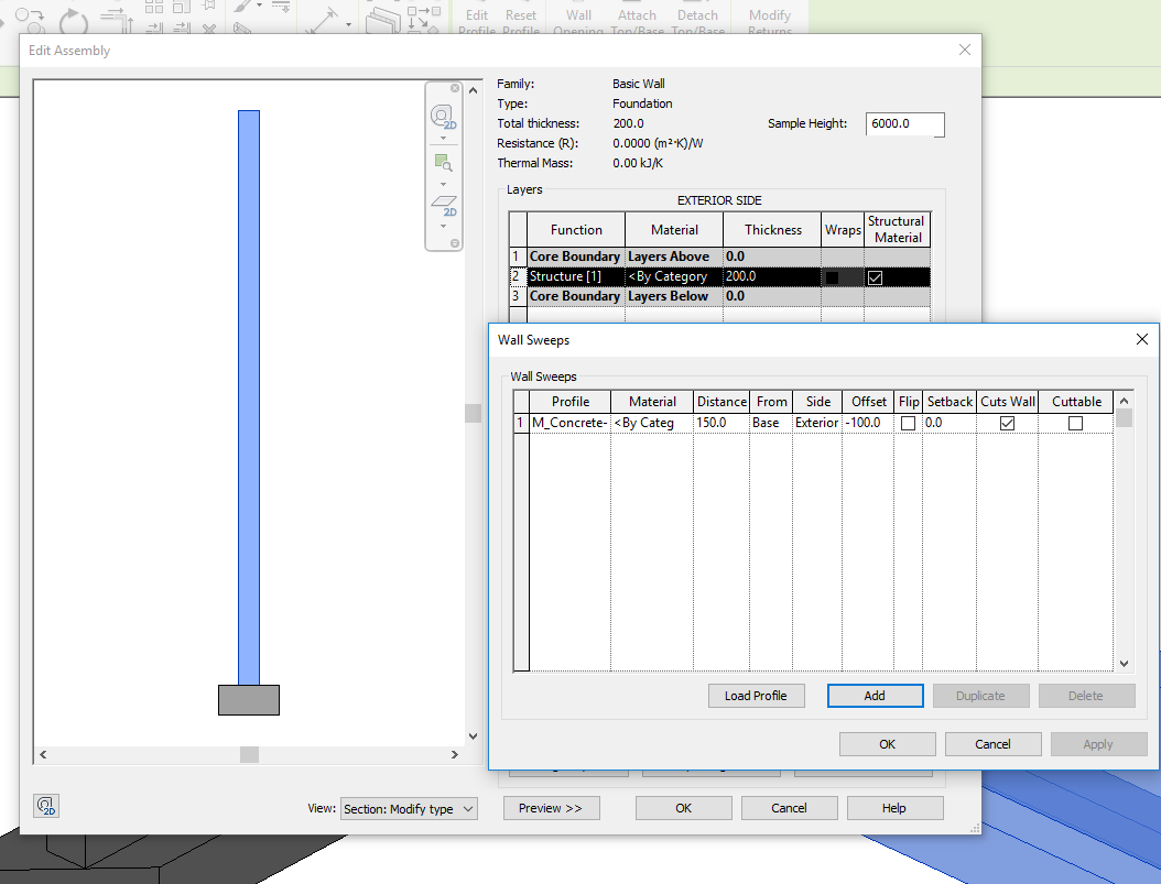

Hello, I have a problem with joining wall with footing (which is inserted as wall sweep). How can clean wall and footing joint. Wall is joining already correctly, but the sweep is not.

I added revit file as well

I would rather use the Foundations (wall footing)in Revit for foundations.  These clean up properly.

I agree with Tim.  Don't use a wall sweep for a foundation, it's not really what it's intended for.  Use the footing tool.

Hei, yes this worked out well, but just wanted to know if there was other way as well. Later if I will use sweep on top or somewhere else then I will see if I come a cross on this issue again, but until then thanks.

Sweeps embedded in walls are hard to control, I avoid them as much as possible.
