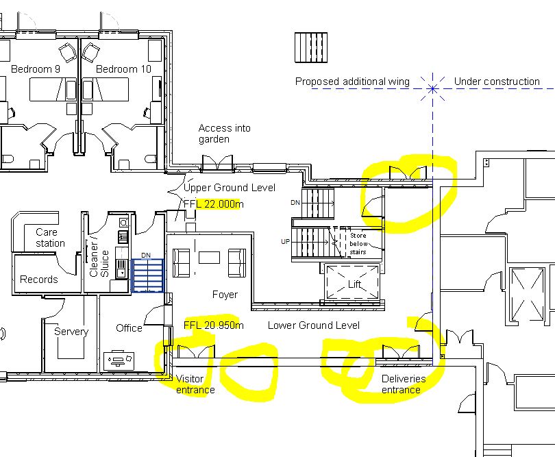

Please see attached a building I am working on. The floor plan is split levels due to the topography. The view depth is okay for the 'higher' floorplan, however this in turn means that Revit is not cutting in the correct place on the 'right hand side'. Please advise how I will resolve this issue?

Add a plan region.  Learn to use the HELP, read about plan regions here.
