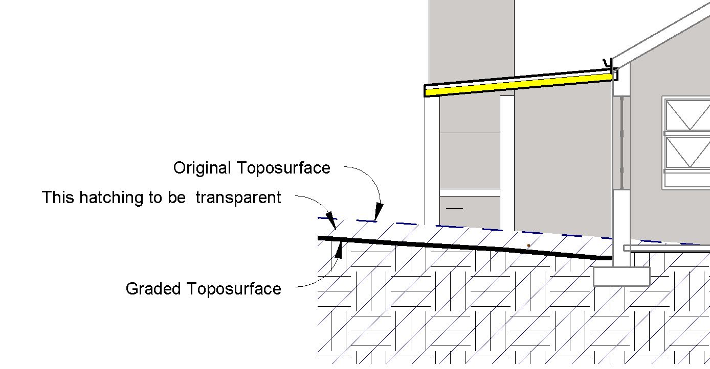

I would like some help, When I have a Toposurface, and create a Graded Topo same as the existing one, and do some grading work, I would like the Original toposurface hatching to be transparent invisible. Thus I only want to see the surface line. See attached Image.

change the material of the existing topo to be 100% transparent?
