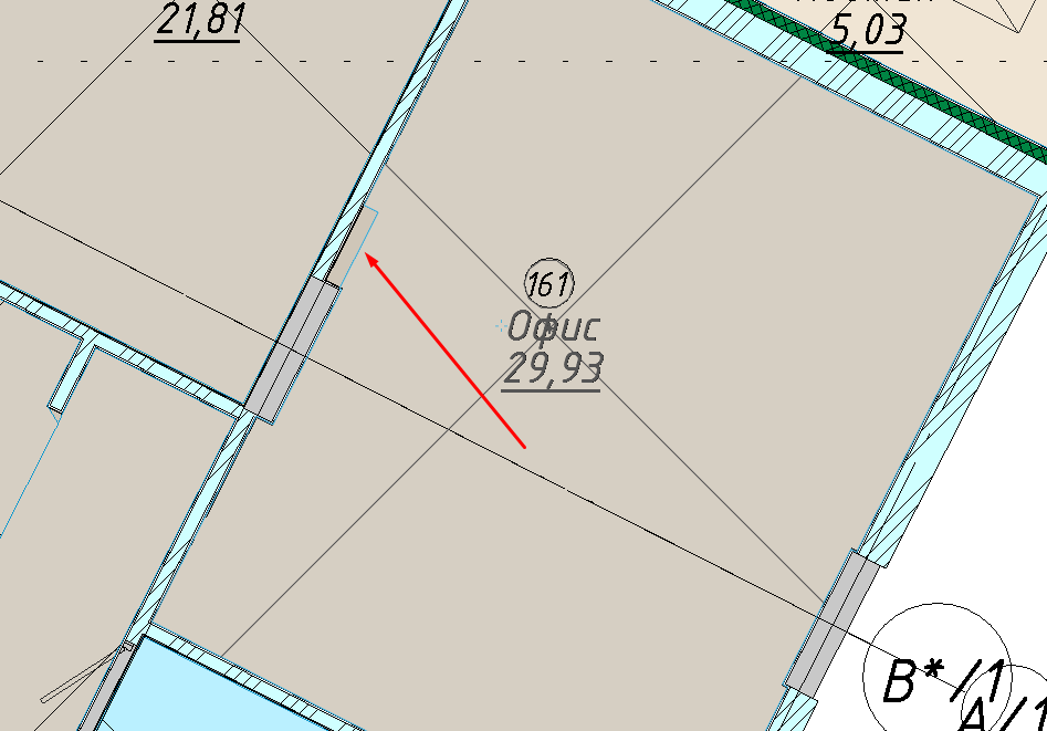

Hello,
Our building structure is a separate file. Previously I placed my room tags as per the old design. Now some columns shifted 700mm down. After I reloaded the structural model and tried to place room tags again it is showing me the room boundaries as it was before like the column did not shift. My room boundaries box in the properties is ticked by the way. Please check the attached snap. Thanks in advance.

It may be that the column was originally drawn without room bounding on, and then a manual room boundary was drawn.  If the column is moved, the boundary wont move with it unless the lines were locked to it.  In this case, you would have a static boundary line and an automatic boundary line.

I was only using standard room tag which automatically finds the boundary. I haven't found a reason yet, however our structural columns moved back. But still it is interesting to know what is the reason. May be something with the structural model.
