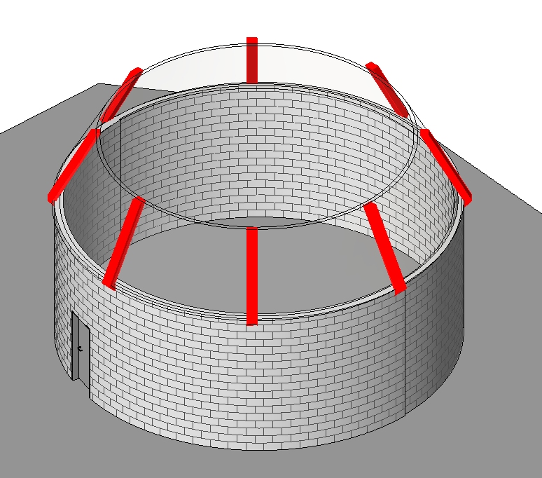

This is my suggestion done with Solid > Blend and Void > Blend and the mullions are just Solid > Extrudes

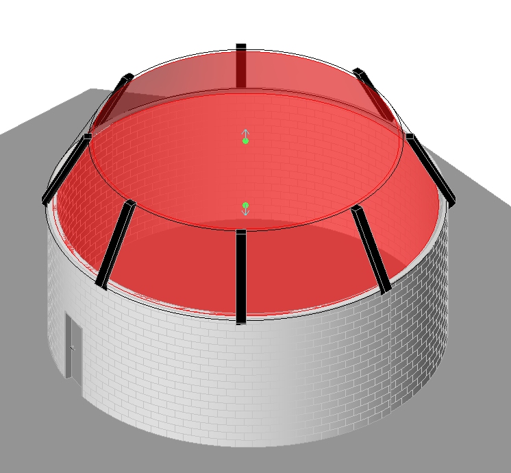

Here you can see the glassing. You can use whatever family you like. I used Roof!!! because I could not find any family for Curtain Walls It is one Blend with Solid and another inside made with Void

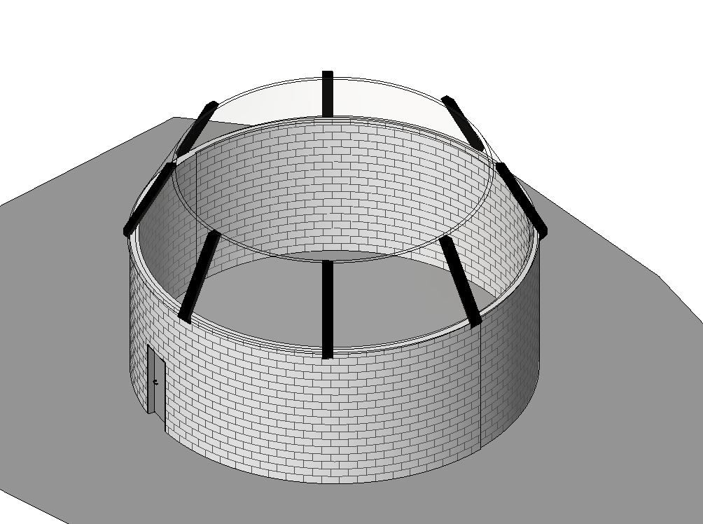

And here are the homemade " mullions". First make a wall going North-South or in some other direction. And then Modelling > Create choose some arbitrary family: Entourage??? Then... Just do one mullion by Solid Extrude. using a side of the wall as a workplane Mirror the first extrusion in the same family Copy the two mullions Rotate them If you want more mullions just copy and rotate Finish the family

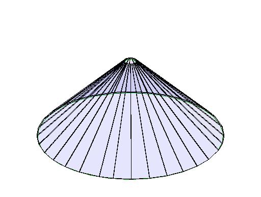

Here is an example of the ruled curtain wall method I suggested above.

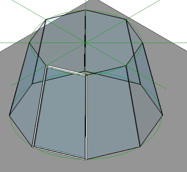

The ruled curtain system suggested of Mr Spot turned out to be so nice to me so I had to test it myself. The circles had to be divided a lot of times so it was some work to do before applaying the curtains.... And you cannot use curved glass But it is the method... Yeah! Really niice

Mine was done with only 4 lines (2 lots of half circles). The other advantage of this method is you can easily adjust the height of the cone by adjusting the levels the lines were drawn on.

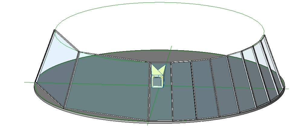

Thanks for the tips. It was only to use Modelling>Curtain Grid to split the big window you got first got then you used Ruled Curtain Systems on a part - quarter - of a circle But I got a bug using this method ... Have a look at the image.,.. I think it is a bug... Something is it?!.,
