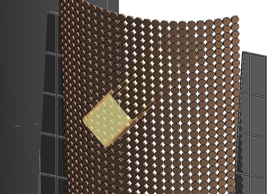

Hi everyone,
In my project I've created a mass conceptual surface, dotted by cylindrical components. Well, now I would "open" a window within this surface... How should this be possible? Cut Geometry doesn't work...
The screenshot attached shows the yellow cutting geometry that I would it may cut the dotted surface...

Cut geometry would cut partially through one or more of the cylindrical components which is probably what you dont want.
Can you give each of the cylindrical components the parameter option to turn it invisible, then you just select one or more and hide them.
