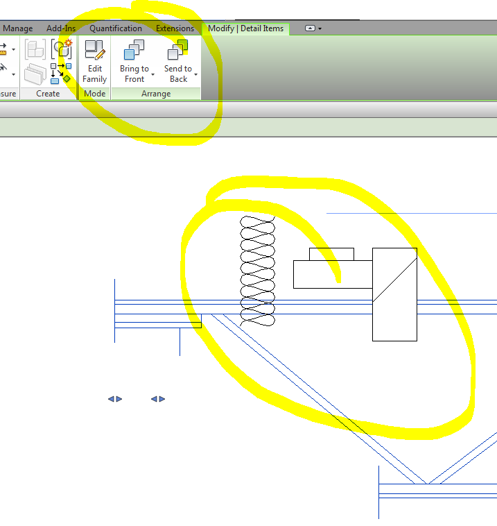

Where is the draworder buttons in Revit 2018? Thank you Byron

Tue, May 1, 2018 at 7:05:48 AM | Draw Order
Try this ...

That is what I am trying but the buttons do not appear after I select the detail?

It doesn't work with modelled elements.

When you select a Detail Element the draw order buttons show up on the contextual ribbon.
