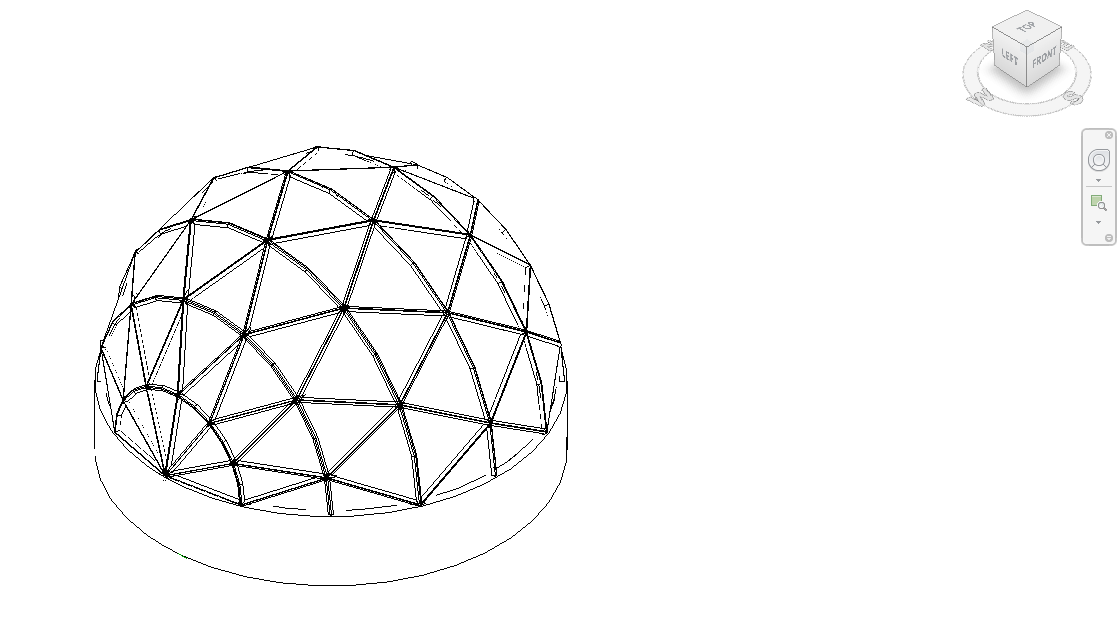

Designing a geodesic dome designed structure. Currently, I was only able to make a frame for the structure; However, when I try to edit the family and create a solid space within the framing void space I am unable to do so. All I want to do is place 2 doors, and 4 windows on the structure. I'm not very well versed with using Revit, so I appreciate any help I can get. Thanks!

People normally use adaptive components in Revit to create building forms like geodesic domes. They can be tricky though. But in your case, you could simply model and in-place family as a door/window and model them exactly where you need them within the model.
