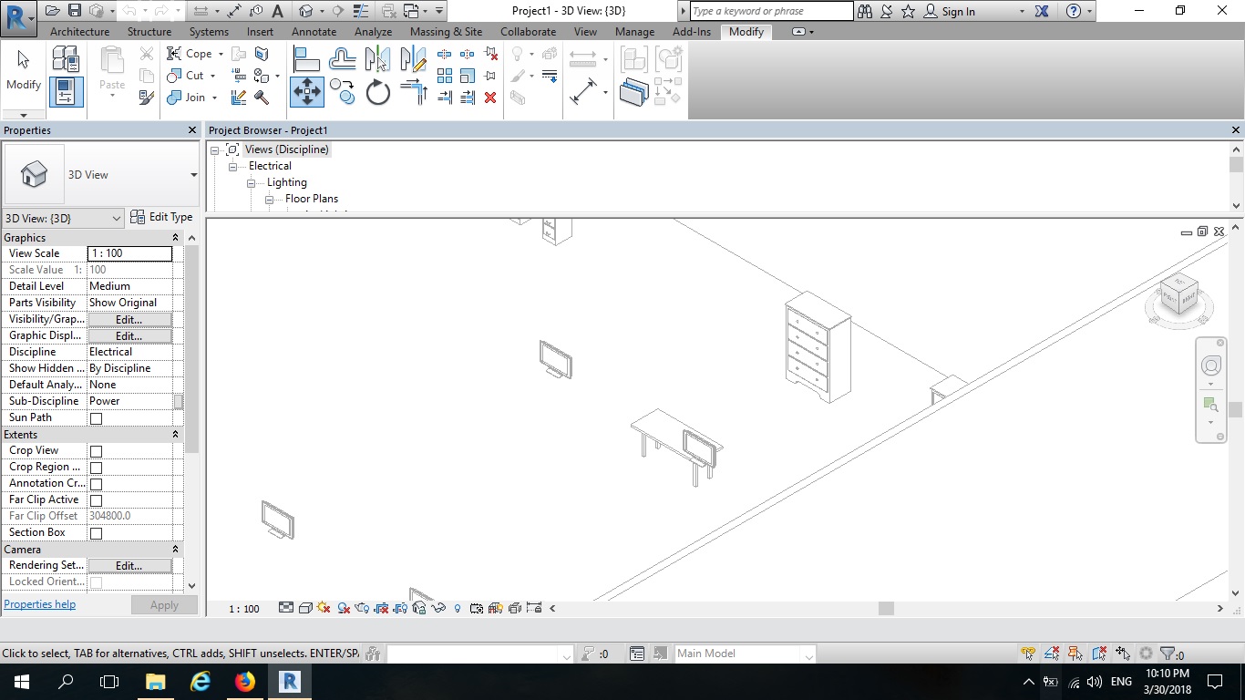

i am new user for revit, i still learning how to use, my problem that after i finish draw a building and save the file, i try to modify wall or window or anything in the drawing, i find everything is in grey color and cant be modified, i dont know the reason why i cant modify

Is the problem only in 3D view? How about other views? Try to delete this 3D view and create a new one. Sometimes 3D views go corrupt.

In all views . Always walls looks grey and cant edit or modify

Look at your discipline.

Sorry. What is Discipline
Sun, Apr 1, 2018 at 7:37:36 AM | modify issue
Are you really doing electrical?  That's what your view setting is set to.  I think you need to be in architecural.

Yes i am electrical power engineer but never use revit before and i try to learn it to improve myself

The discipline setting will control how elements are displayed.
Pay attention to the small icons on the lower right of the screen and read this.
You are probably using view templates that will also control what is displayed and other controls.
