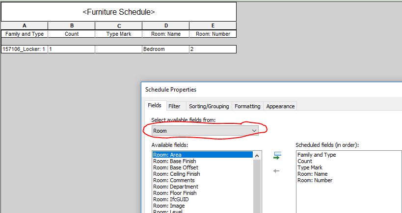

i have a locker family and i would like to create a schedule that shows the lockers that are in each locker room (mens & womens.) i have created a furniture schedule and included these fields; room name, room number, family and type, mark, count, type mark. when the schedule is created the columns for room name & room number are blank. it seems as though my lockers are not associating with the room that they are located in. i have moved the room calculation point so that it is not on the ground plane and not in the center of the locker family and still no luck. i was hoping someone has a solution?

How did you get the Room Name and Room number parameters?  In your furniture schedule, also choose from the room parameters - they are then included in the schedule.
