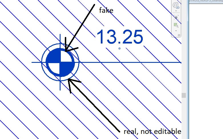

Hi, is there a way to change the size of the circle of the target symbol? when you edit the family it is only the inner solid forms what you can edit but not the circumference itself. I tried to fake it by doing it with regions but original remains the same.
Thank you

When you edit the familly, go to Familly Types -> Radius

No, it was easier, i just had to turn "on" the visibility of lines, but the issue is that the Visibility/graphics button in the symbol family editor, is not in the instance properties window but only in the ribbon, and that is why i hadnt find it.
