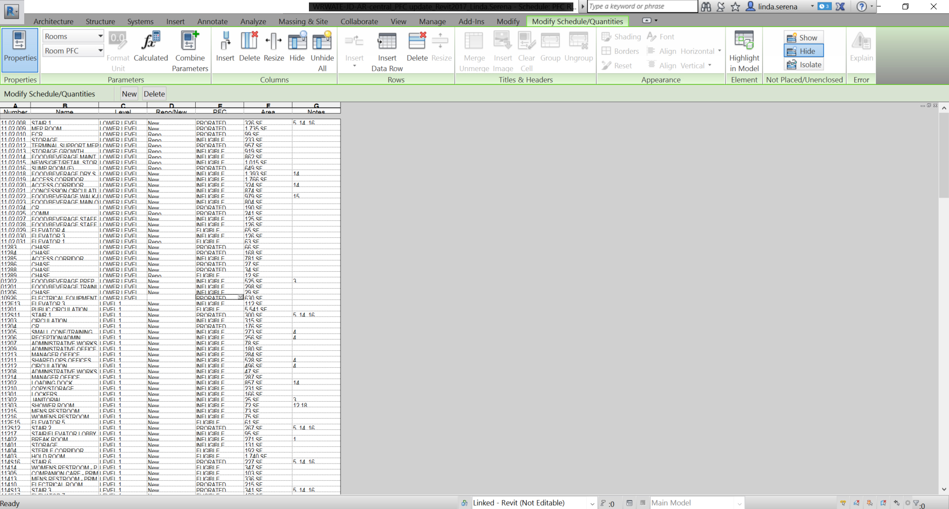

Hello. I upgraded a project from 2015 to 2017. The room schedules are difficult to read now in 2017. Cell heights are not tall enough to fit the entire text, regardless of the text size (I've made text smaller/larger and it appears the same). The resize option in the ribbon (under Modify) is greyed out, so that is not an option. It looks fine on a sheet, but I can't edit the information in a sheet view, I've always done that in a schedule view. I've attached an image to help clarify.
How can I adjust the cell height in the schedule view?
Thank you.

Did you follow this in your HELP?

I did look into that - the text size does not affect the height of the cell, unfortunately. The cell still covers part of the text regardless of the text size.

Have you got all of the updates installed?

Yes - I just installed the program a few days ago so all updates should be installed. I am on a trial version - maybe it has something to do with that? Other graphical elements have been out of whack, but fixable or workable - such as my navigation bar and project browser showing up blank and other similar things.

Are you running this on a 4K monitor as Revit doesn't get along well with them.  This looks like a similar display error.

Nope - not a 4k monitor :/
