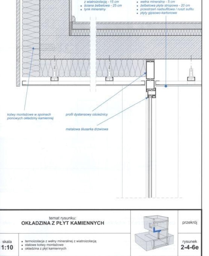

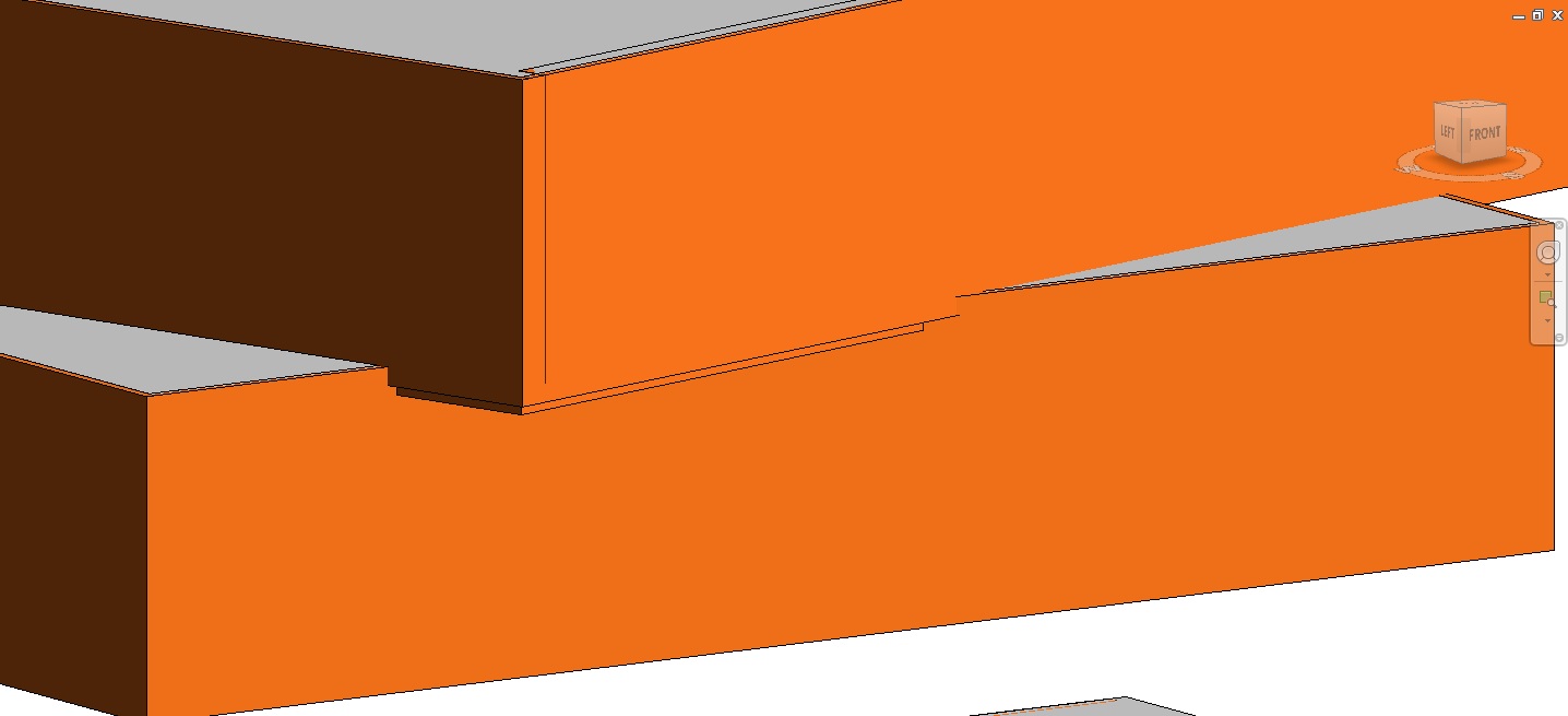

hello guys, I have problem with some details. Last time I used revit with this problem I used filled region and draw by line details, now I have more time to solve this problem. So I want my horisontal and vertical layers of wall to join on corners (inside and outride corner). I tried to separate structural wall and insulation wall but with no result. Also I tried modify wall in section but then I have problem with same walls on other places. Can somebody please help me with this. Tnx :D

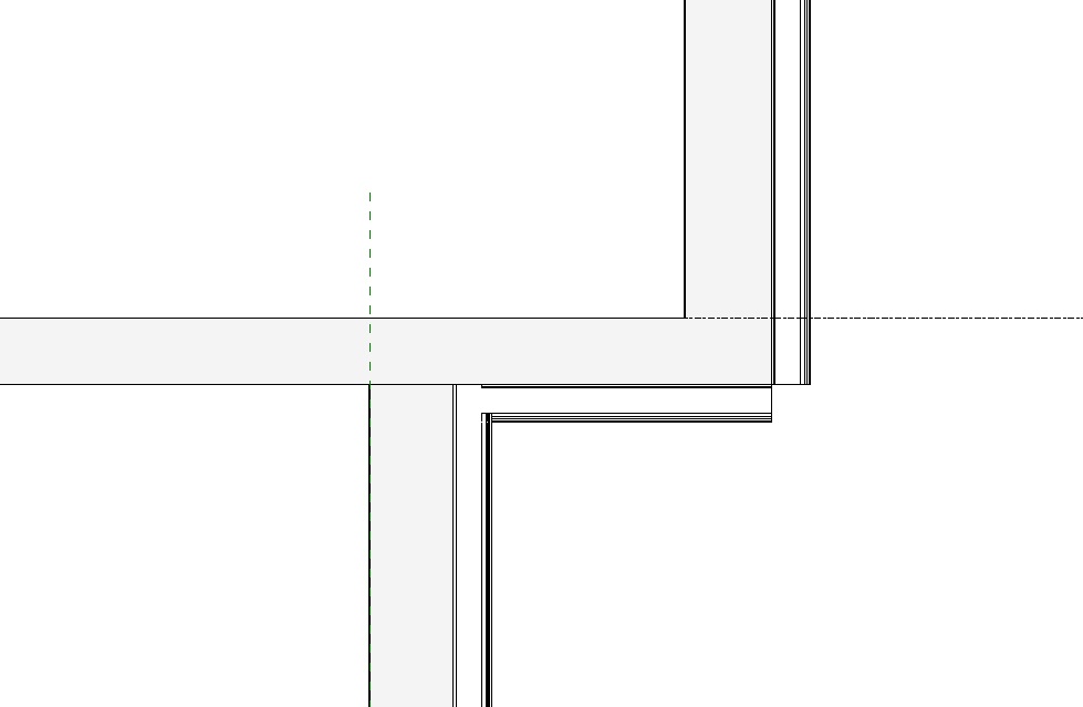

that is for plan, this second picture is section... it doesnt work...
Mon, Mar 19, 2018 at 6:19:35 PM | Horizontal wall
Only plan joinings are available for walls.  Different joining is available for floor/wall connections.
The vertical wall can have a layer pulldown.  As for your 'horizontal wall' - You need to tell us more about what that is.

vertical wall layers go to horizontal and then again go to vertical, something like outside ceiling with layers like wall insulation plaster etc.

here is section now do this in revit! Smile

I tried soffit, ceiling, doble flooring, everything, and it is not possible it doesnt connect like two walls in plain section... and i cant find nothing on autodesk help

First, understand that modeling and detailing are different requirements.
Second, batt insulation is never shown as batts except in detail views using the built in batt symbol tool.
I would model as:
  1. Floor - either one complete floor with those layers making sure priorities are correct so join with wall works
  2. Floor - or two floors - structural only and seperate finish floor (probably what you should have.)  Floor limit is inside face of insulation, then use join fuction of floor to wall.
  3. Wall beginning at top of stuructural floor - defined complete with outer layer unlocked for pull down function
  4. Soffit - finish with insulation and furring layers  (Soffit limit is inside face of exterior wall finish to curtain wall.)
This should give you the correct visual model.  Then in section / detail views, you edit cut profile if needed and add dtail elements for stryucture, insulation and CW.
