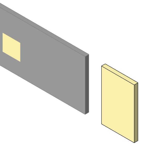

Using Revit 2018.2 - when I demolish an existing window in an existing wall, Revit quite rightly infills the window void with a section of new construction wall to 'block up' the previous window. I have set up my colours (phase visibility graphics) to correctly display existing, demolished and new walls which is working how I would like. But here lies the problem - the section of new construction wall blocking up the previous window opening is not showing up in the colour that I have set for new walls. Any ideas? The drawing is going to client tomorow

Check that your view is set to 'Show All' and not 'Show Complete' in the New Construction Phase.
