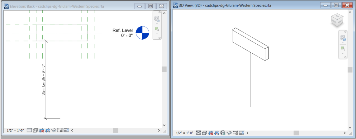

Thu, Mar 8, 2018 at 3:01:11 PM | Can't see Structural Framing from attached Revit Link in any Floor Plan
#12
dgcad
dgcad Avatar
Joined: Thu, Mar 17, 2005
1231 Posts
3.5 Stars: 36 Votes
Hmmm ok here's the beam family. Open it up and see. It has a model line that dangles down and uses the paramter 'Stem Length'. This 'stem' will extend down into the 'cut plane' below so it shows up in the floor plan below. The stem has two parameters. length and On / Off for visibility.
Enjoy !
