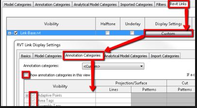

I am cutting sections and have noticed that the linked in architectureal model that i have set to be underlayed beneath my drawing has lines showing through what i have modeled. (see attached) My goal is to show the linked in model lightly in the background without the lines protruding through my modeled elements such as the columns. Is it possible to do so?
Thank you for your time!
Thu, Mar 1, 2018 at 10:55:06 AM | Revit Section Setting Question
You control linked elements seperatly (both model and annotative if using linked view) in the VG window.
Read this from your HELP.
