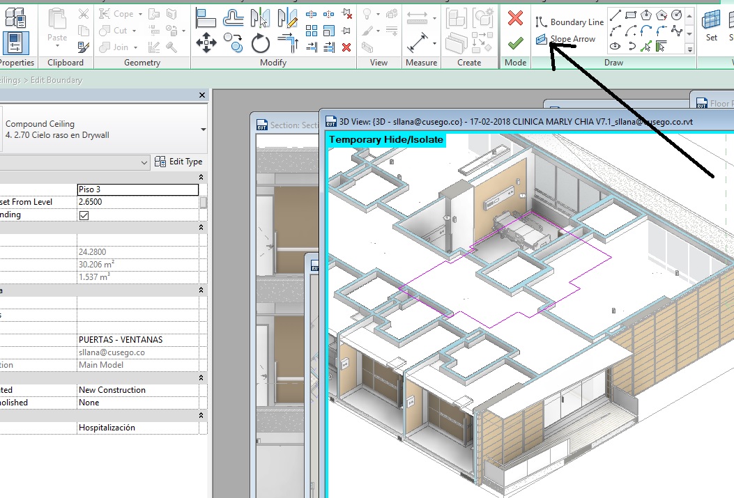

Edit the boundary of the ceiling and add a slope arrow to it, select the arrow itself and set the values to head and tail

You can also click on a line of the sketch and on your options bar (top of your screen) click the "Defines Slope" button and then you can add a slope such as 1/12.   Remember you can only do one slope per ceiling so if you have a vaulted ceiling you would need to separate ceilings.
