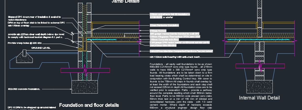

How would I create these walls, would I need to set levels at top and bottom of concrete slab, I am currently learning how to use revit.

Walls do not include floors.  Look for some revit youtube tutorials to help you.
