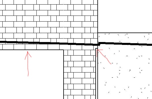

As you can see in the attached image, I have pulled up my exterior brick veneer layer to just below grade.  However, I can't get it to pull up at the corner.  I have pulled up the two faces, but where the side wall, wraps the corner, it's still brick.  I know I can just annotate over it with a field region to make it look correct, but I'm trying to avoid doing that.
RevitLT 2018
Thanks.
Mike

Try changing your wall joins to miter.

Thanks, that worked.  Created some new and interesting visibility issues to work through now.
