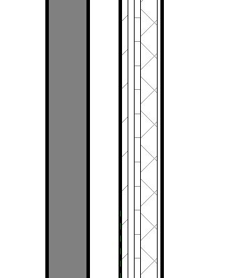

I have walls on the existing phase that are greyed out but not showing the all of the layers of stucture inside the wall. I can get it to show either or but not both. Is there a way to have an existing wall that is grey and also shows the layers of that wall?
The attached image is what I currently have for Existing and New walls. I just want to show the detail of the new wall on the existing without losing the grey.
Thanks!

Nothing really simple.  Here is the answer
https://forums.autodesk.com/t5/revit-architecture-forum/how-to-show-detail-on-walls-existing-phases/td-p/6211811
