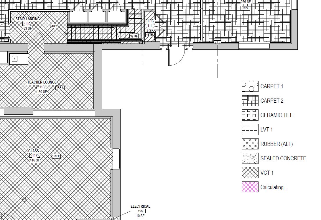

In Revit 2017 here. When I print to the printer a sheet with the color fill legend it is fine. However, when I print to PDF it adds another entry called calculating. Using Adobe PDF printer. Any ideas?

its a bug and here is the workaround :
https://knowledge.autodesk.com/support/revit-products/troubleshooting/caas/sfdcarticles/sfdcarticles/Revit-color-fills-calculation-does-not-complete-before-pdfs-are-printed.html
