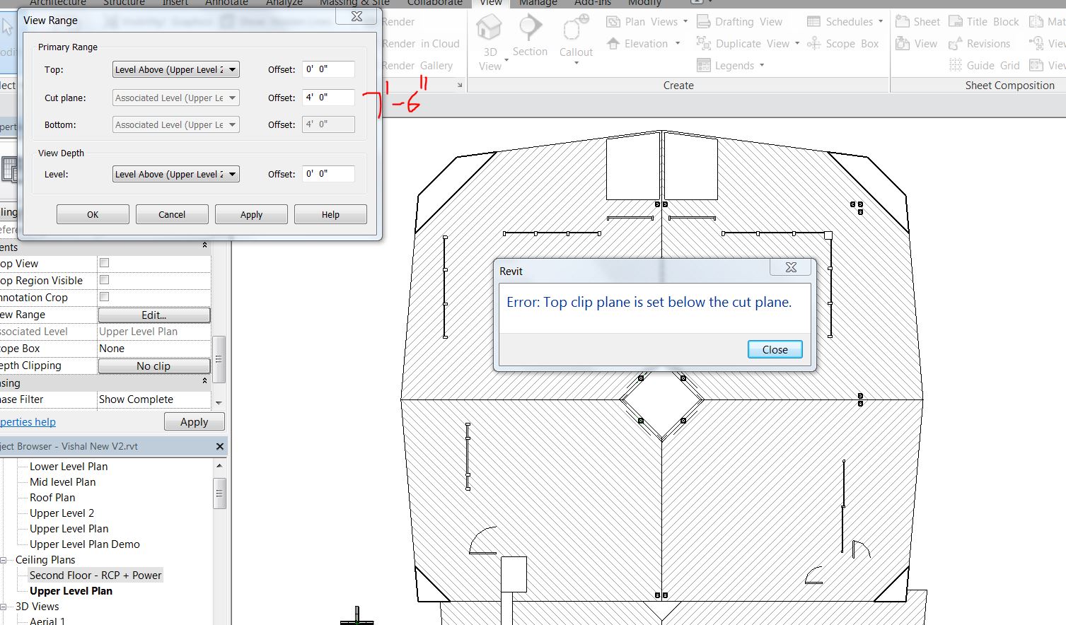

made an RCP plan view. its cut plane was at 7'-6", i wanted it at 4', but no matter what numbers i put, or even adjusting the pull down view depth choices rsults in this message. see pic. how does one deal with this.

I always make the top 2 the same.
