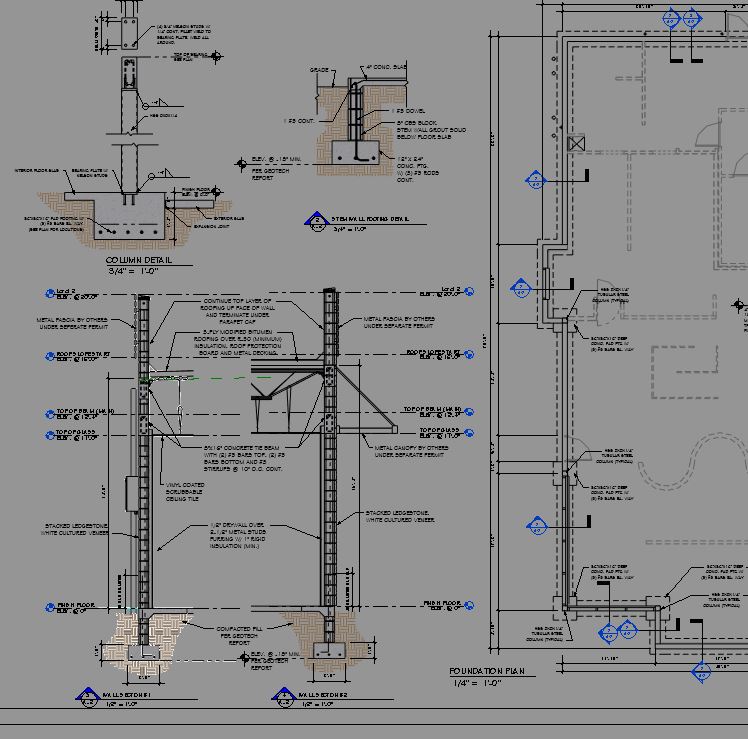

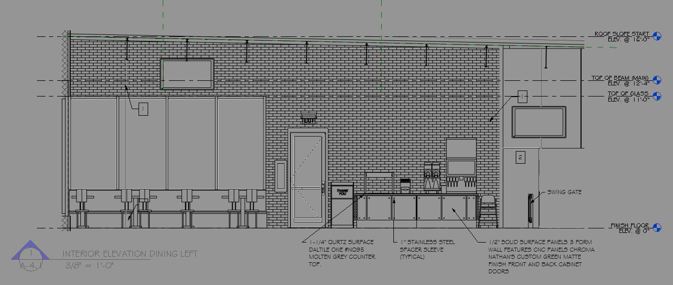

I am working in RVT 2017, and have project in which there are faint white lines around everything in a couple sections, not all sections just a few. Does anyone know what this means? It doesn't print that way or affect the way anything acts, I am just curious...

The outline shows whether I have thin line view on or off.

I do not beleive it is the object styles statement. Here is another screen shot (with no thin lines). It has two wall sections, one with and one without the ghost lines... Same project, same settings in each view...

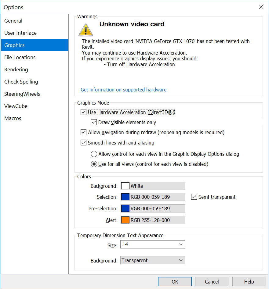

Thought #1:
Check your NVIDIA Control panel to make sure that there wasn’t a 3D setup done on your program (Revit).
Right click desktop, Nvidia Control Panel, select "3D Settings" then "Manage 3D Settings" then "Program settings" Tab.
If Revit is not listed nothing is being controlled by the control panel.
If Revit is listed, but no settings are in BOLD then nothing was changed from default.  You could try setting antialiasing at a higher rate.
If Revit is listed, and some settings are in BOLD then something has been modified from default, and you should try resetting those - BUT MAKE NOTES of what your changing in case you want to set it back.
Thought #2
In Revit, go top Options, Graphics
Make sure Smooth Lines with Anti-Aliasing is checked (It looks like it’s not doing it).
Check "Use for all views (Control for each view is disabled)" if it is not.  This will force smooth lines with antialiasing on.
I've attached what mine looks like for reference.
