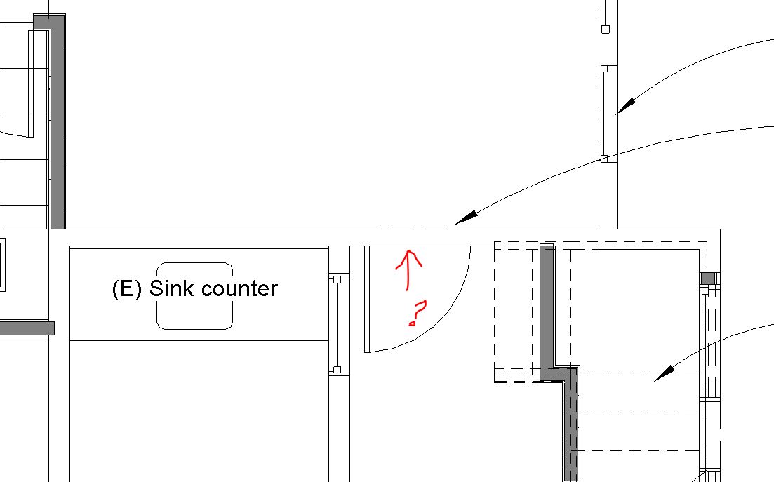

Does someone know how to deal with this? (see pic) the door puts lines on the threshold. one line blocks the dotted line, so my new opening in an existing wall graphic is screwed up. I look on the door family editor, and there are no lines...and invisible line tool doesnt work. its such a crapy lazy graphic i can't stand it, but dont know how to get it to be a clean look. any help would be awesome!

Show us a section through that door.  The elevation of the door is suspect.

The problem appears to be the phasing display.  Look at your phase filters and Graphic overrides for the phasing.
