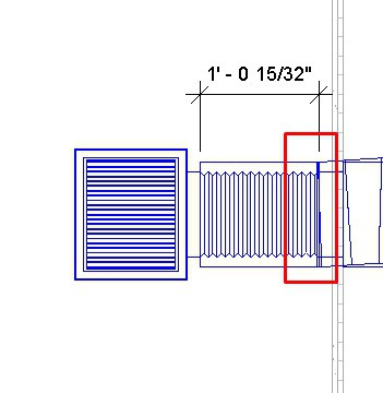

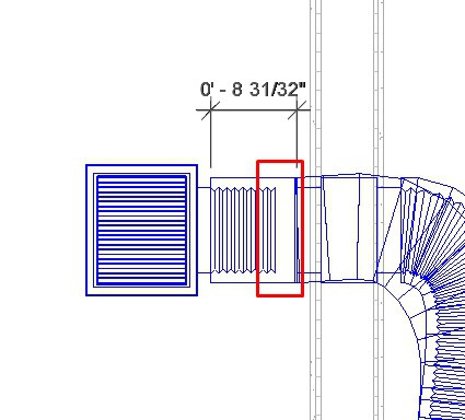

Sat, Jan 6, 2018 at 3:17:39 PM | Why does the flexible duct disappear at minimum length?
Sun, Jan 7, 2018 at 1:28:10 PM | Why does the flexible duct disappear at minimum length?
Beaucoupnice
Beaucoupnice Avatar
Joined: Mon, Nov 19, 2007
93 Posts
3.5 Stars: 6 Votes
Sounds like duct family can't process that length. Can you make it marginally larger - like 0.1mm or 1mm. Otherwise you may need to find or create a new duct with different parameters.
