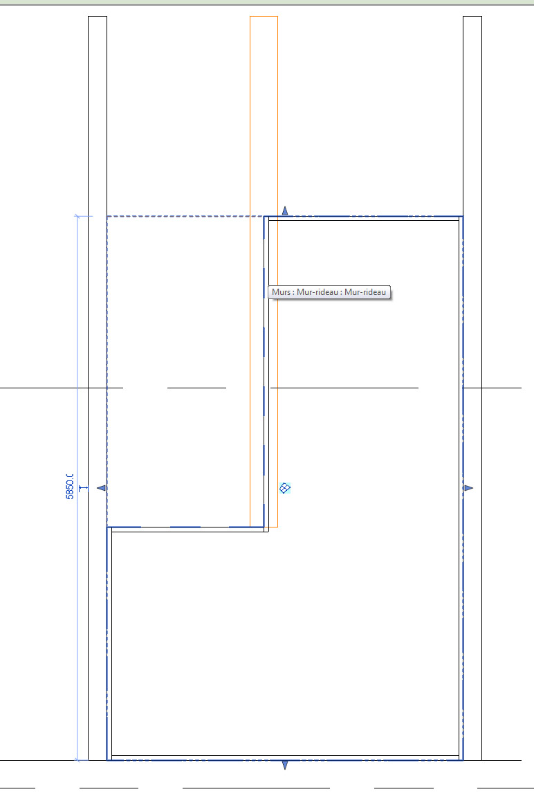

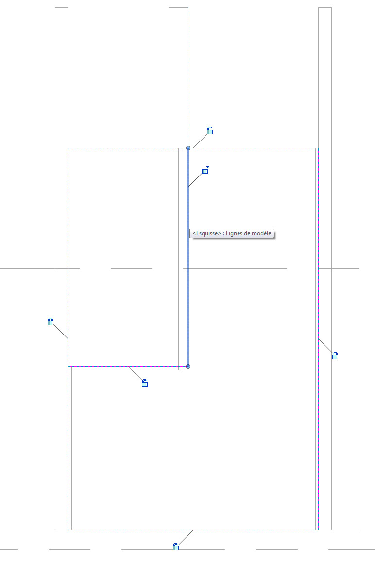

H there,
I want to modify a curtain wall to have it's own form, modify profil,
but the middle ligne keep constraint with the middle of perpendiculaire wall,
I try constaint lock edit joint,dissalow joint   nothing work
how can have the limite then the mullion align with the right exterieur of the wall,
thx you a lot,
perfect

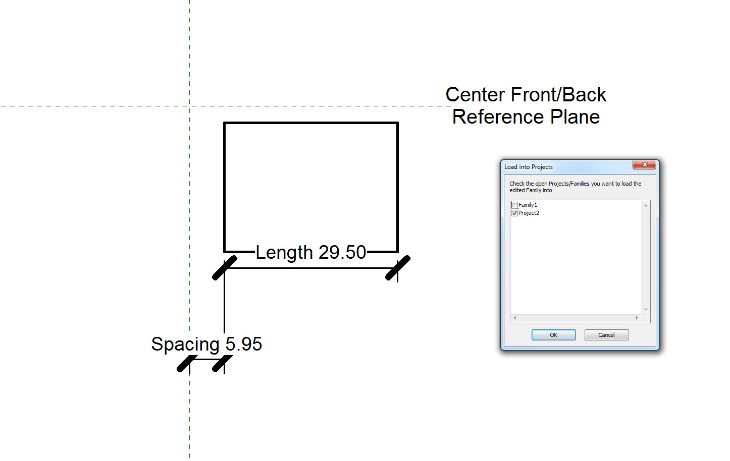

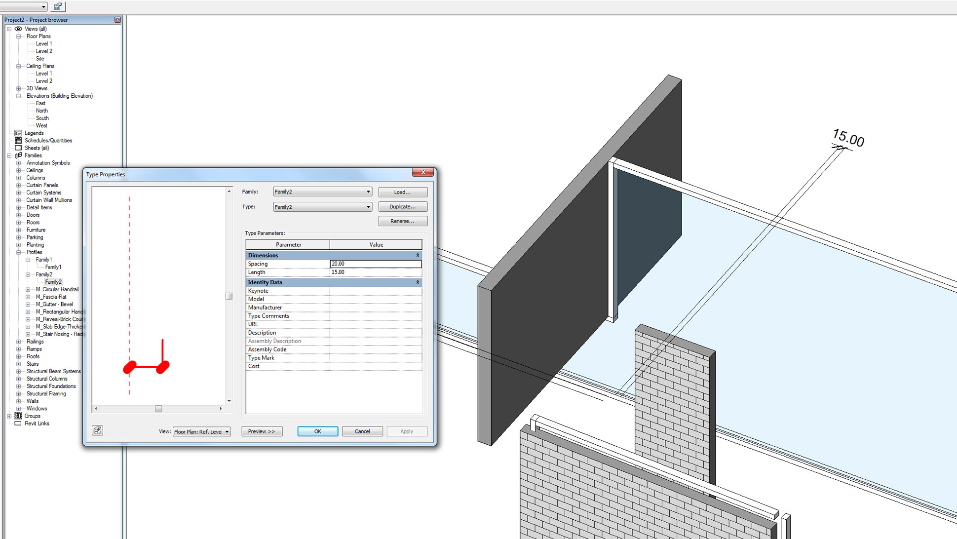

Thu, Jan 4, 2018 at 4:34:23 AM | Modify Curtain wall Profil
thanenbauk
Joined: Mon, Jun 13, 2005
14 Posts
Ok great I achieve to add a parameter spacing to the profil mullion, also a Length & wide parameter, so you can edit the mullions profil , as is become a families and no more a system mullion, then You can edit the profil of the glass panel, so problem fix except in the case where you panel is not a "system panel" like glass or solid , in my case multi-layers wall with isolation , in this case you can't edit the profil, but it work fine for system panel edit_profil.jpgprofil.jpg thx a lot any thought about the system panel ? I can make in-situ panel just for this panel,
