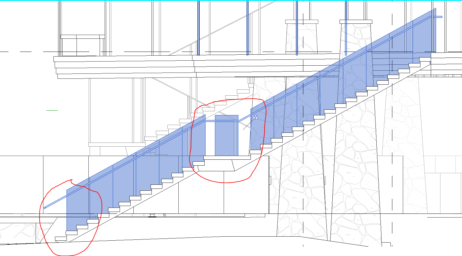

i have a stair with a glass panel railing and at the the landing the panels do not seem to connect or join as one might think they would. the panel is a 24" wide glass panel that is my baluster. i am not sure where I went wrong. i am attaching a screen shot of the stair and railing and also attaching the stair and railing revit file

I wrote this several years ago: You can always break these up into multiple railings and use in-place elements for transition areas.  Maybe just three seperate railings will work.
BTW - Something is strage at the right side of the landing where the panel 'leans'.
