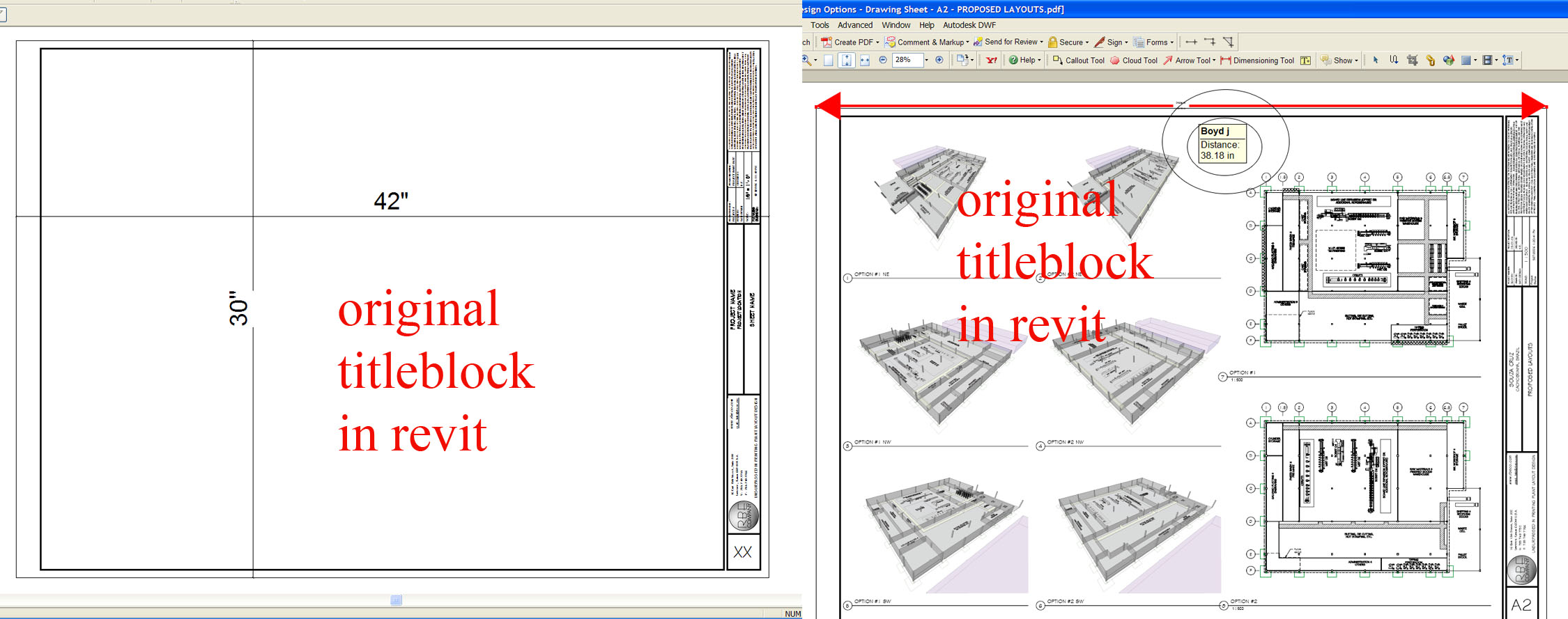

Why does REVIT shrink the sheet when it plots? I have read other post with similar problems. you make a title block 42x30 - revit gives you that box already drawn when I make a new title block. I put everything on the sheet like i normally should. When i go to plot i choose the appropriate paper (E1) AND I PLOT AT 100% - when I plot...say to a PDF it is 10% smaller!!!!! From what i can tell is...Revit grabs the original frame it gave me (30x42) and then places THAT sheet on an actual 30X42 sheet when i go to plot...It gives the page some margins OUTSIDE of the 30x42 box...therefore it shrinks the overall drawing. I know i have to be doing something wrong...what is it...please help...see attached image please. Thanks Boyd j.

Ont he Print Stetup make sure you have "paper Placement" set to "no Margin" And the Zoom to 100 percent ofcourse and see waht happens. This has helped me a couple of times.
