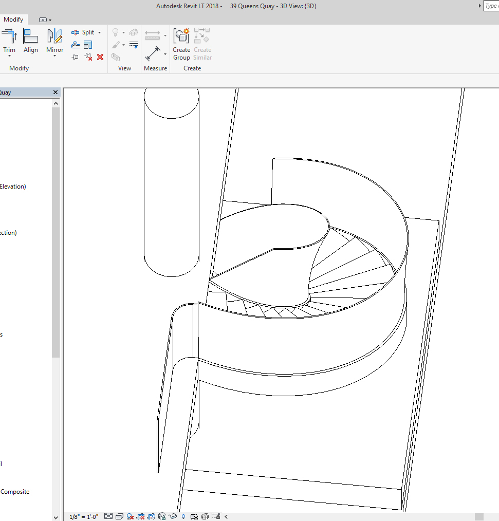

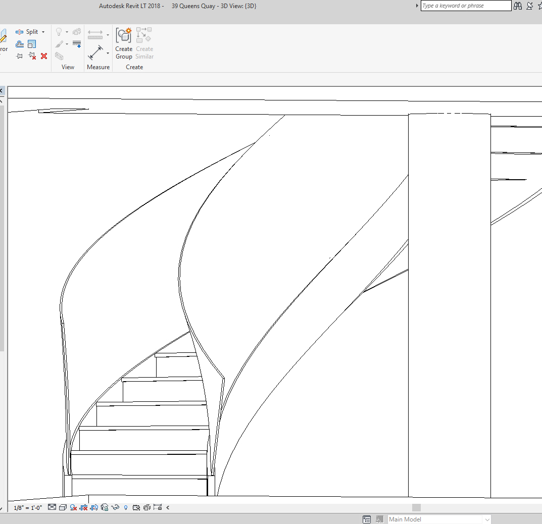

I've tried creating a curved glass guard for a curved stair by creating a railing profile approx. 36" x 1/2". I'm not sure what is causing the profile to distort when it is sweeped, see picture. Any insight is appreciated.

Solved - Needs to be modelled in the full version of Revit, these curved guards were drawn in LT.
