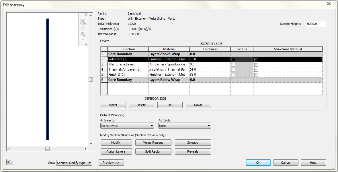

You can add profiles to walls by selecting wall > edit type > edit structure > expand preview > change view to section > add a sweep.

marmiketin1 - does that method add it to all walls? I only want it on certain walls in certain sections.  I can add a sweep to any wall, but the profile of the sheeting sits the wrong way.  It needs to sit flat against the wall, but it sits parallel to the wall and back into the wall.
