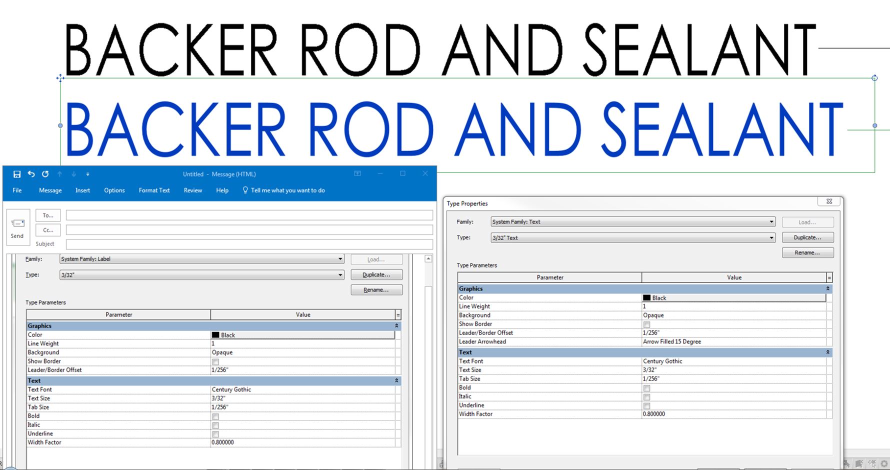

i cant figure out why the text of my keynotes won't match the text of my main project. All the paramters are the same between the main file and the keynote family, ive attached them to the image
if you could let me know how to fix this id appreciate it. Thanks

I assume your Keynote is a tag family. Open that up and check the text size there. You may need to duplicate that text in the family to give it a unique name. Then reimport back into model.

The keynote is a tag family and the text within that family has a unique name and the size and every parameter is the same
