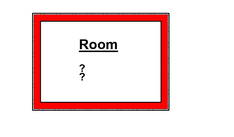

I have added (2) note labels into my Room Tags so that we can type information in them pertaning to the room.  However when we don't have anything to note it still shows the "?" where the tag should be.  Any ideas how to get rid of this?

teafoe5, just add lines to your tag family – frame will do (invisible lines do not work). Or, I don’t like it too much, but you can also create visibility parameters for each label.

Hmmm thanks guys!  I'll probably end up using visibility parameters.

The reasoning in ‘Additional information’ paragraph makes perfect sense if only one label is used. With more than one label and at least one not blank, it shouldn’t happen, imho.
