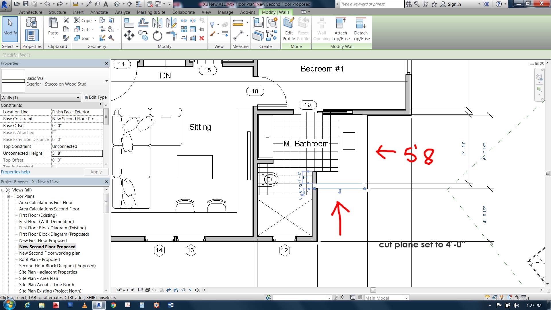

So this 5'8" tall wall has a little bit of glass curtain wall sitting on top of the 5'8" wall. But I I just want the wall to show as a CUT wall, but it doesnt want to. though, if I set the wall height to 6 feet, it changes to cut pattern immediately. so that controls the graphics, not the cut plane?!
the cut plane is at 4 feet. Ive confirmed that for myself. Why doesnt this shorted wall get cut? what is it about the height that makes this a problem?

Read this to understand the why this happens for future reference.
Then try either of these:
  1. Make the low wall taller and embed your curtain wall.
  2. Make the low wall taller with a top - negative offset.
