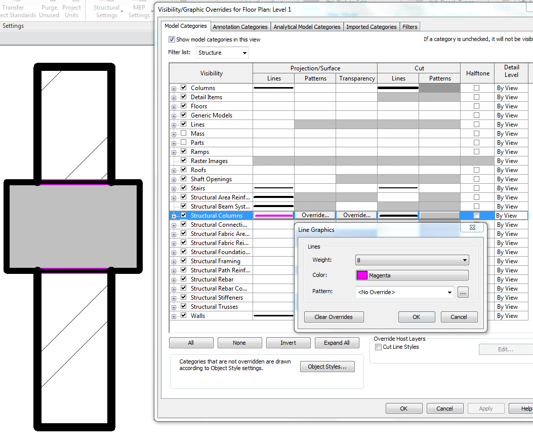

Hi
i cant control the line properties at the joints of wall and structural columns.
please find attached snap. is there any solution?

Some Options:1) Go to Manage - Settings - Object Styles - Model Objects - find wall and/or column and change settings. This is where you change them globally.
2) In plan view, hit vv to bring up visibility / graphics overrides, in new window go to walls or columns and change the lines column to the thickness you need. This changes all walls amd / or columns in the view only.
3) In plan view, select the wall or column, right click and select override graphics in view and select by element. In new window change projections lines, or cut lines. This changes only the wall selected.

I think you answered without a try
i tried all those things.

My question is about the line between a column and wall when it joins, that comes as default thickness.
i want to apply thickness to it as normal boundary of column

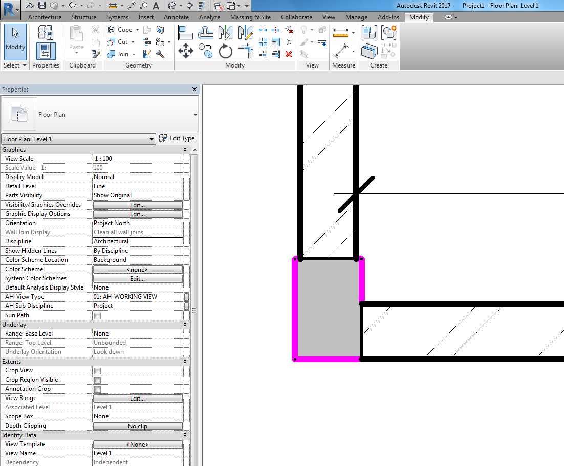

yES I GOT IT
IT IS THE ADJUSTMENT OF PROJECTION LINE, NOT THE CUT LINE OF STRUCTURAL COLUMN. I DONT KNOW WHY NOT CUT LINE
PLS FIND ATTACHED SNAP
