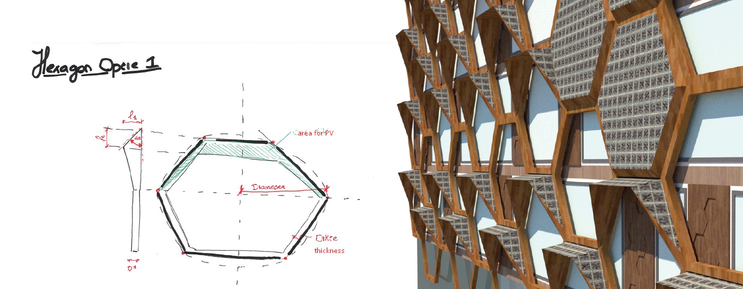

Hello,
I need to create a hexagon shaped facade for this project i am working on.
The goal is to make it adaptive, so i can place it with dynamo and flex it’s shape, size and position on the building for optimization and communication.
The hexagon itself will need some parameters as well, they are shown in the attachments.
The following parameters are requested:
  • -          Diameter
  • -          Thickness of the profile
  • -          D1 : Depth of the profile
  • -          L1: Length of the fixed sunshades
  • -          Angle of the fixed sunshades
  • -          L2: Length (reporting parameters, since this will be the result of L1 and the angle)
  • -          Area of the fixed sunshades for PV placement and calculation
I’ve been able to make this in sketchup, so an example is also attached.
I’ve been struggling to create the shape because of the void that should flex along with the system.
Any tips or suggestions / exaples would be greatly appreaciated!
Thanks in advance!
Timmo
Wed, Nov 8, 2017 at 2:12:41 PM | Hexagon Metric Generic Model Adaptive
Beaucoupnice
Beaucoupnice Avatar
Joined: Mon, Nov 19, 2007
93 Posts
3.5 Stars: 6 Votes
Do these help?https://www.youtube.com/watch?v=pUO-Hq1gIb4
https://www.youtube.com/watch?v=BP-GzBeQ5Fw
Theres a few others there as well.
