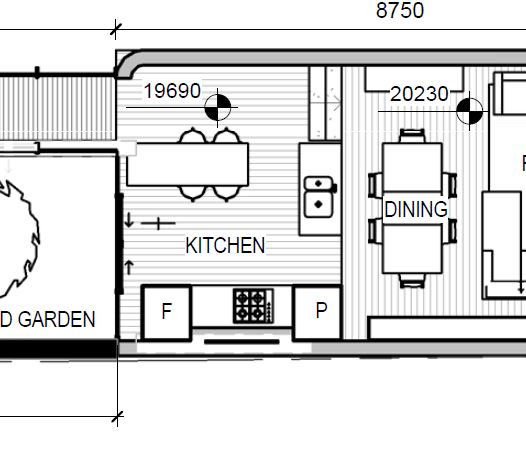

Greetings All,
I'm having some serious head scratching over here, please help.
All of my furniture, doors, slab edges are plotting bold - is there a global way I can ajust this ?  Image attached.

Assuming 1) Your view visibility settings are set to default ( i.e. not overwritten) and (2) Your furniture family lines setup via the family editor are ok, try - Manage - Object Styles and find the correct category and check the lineweights.You can also check your lineweights per scale via Manage - Additional Settings - Lineweights but this is less likely to be the cause assuming your BIM Manager set these correctly within your office template.

thank, you for your suggestions Beaucoupnice, It took until crunch time to figure it out properly, I'd fudged a few work arounds. It turns out the problem was with my phase filter overrides.
