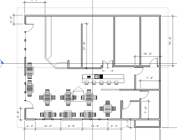

I have a 9' partial drop ceiling with flus-mounted lights.  The remainder of the space is open to the roof above.  The only thing that shows up in the ceiling view are the walls that attach to the sloped roof above (some of the walls show up), I can't figure out which view range to assign - I've tried various settings and watched tutorials, but I can't seem to get it - I'm using Revit 2018 - never had the problem before with Revit 2016 - Any ideas?
I've attached the FP View and Ceiling View...Thanks for helping!
Sun, Oct 22, 2017 at 4:25:14 PM | Nothing shows up on my RCP
Cut some sections through this space so we all can see the walls around the perimeter.
Also show the RCP view properties.
