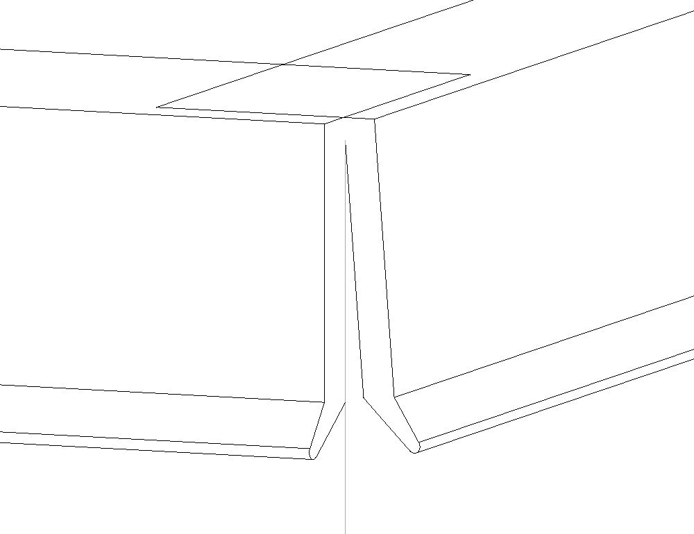

This has to have a solution.  Is there a way to model these so they are one unit kind of like a swept blend but turning at turning a corner?  Revit needs a smart profile for situations like these where there are two host planes and a pivot capability at the insertion point.
I'm sure this is not a new new situation.
Any help?

Wed, Oct 18, 2017 at 3:07:49 PM | Shed Roof - drip edges - how to join at flat edge and angled edges??
Use one roof edge instead of multiples..... One process and the corners will be correct.

You do know that the attachments are at different angles?
There are three angles at the drip edge of a shed roof.
Two are flat at the pitched sides
One that bends downward at the top
One that bends upward at the bottom.
Just thinking how it will be built.
A bending profile seems to be a wish list item.
Using the fascia method buries or dangles the top of the drip edge into/from the membrain layer of the roof assembly.  It still doesn't like to clean up at the corners

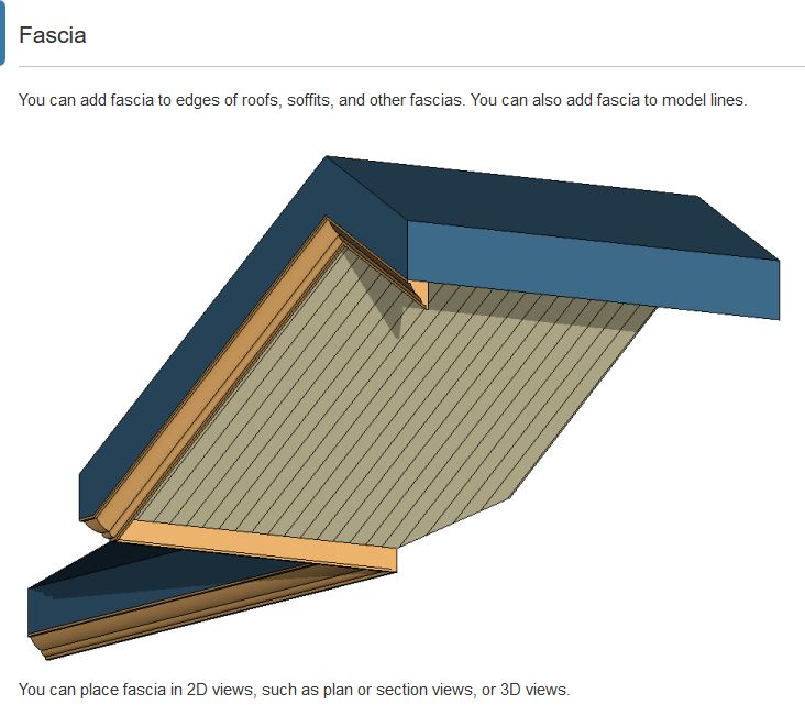

Did you look at the images in this section of the help?
