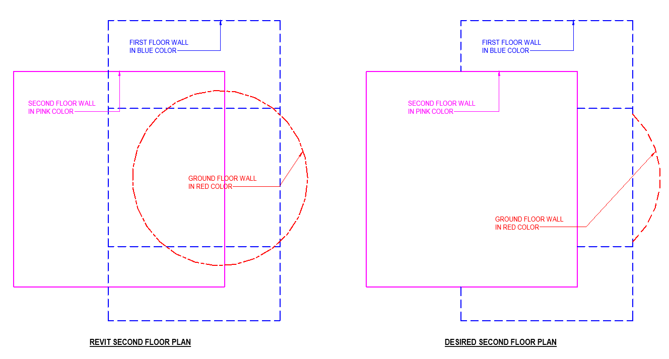

i have a multistoried building,
I am preparaing Second floor plan, but i need to show the content in first floor and ground floor landscaping items that is out side the second floor boundaries.
i used plan region, but i cant arrange it, when i adjust the view range, it shows items even in side the second floor boundary (i.e outside plan region boundary also)
Please find the pic for illustration.
Very much looking forward to getting solved this issue.

Can you upload an image of your plan region that you drew?  Your plan region needs to be outside of your second floor.

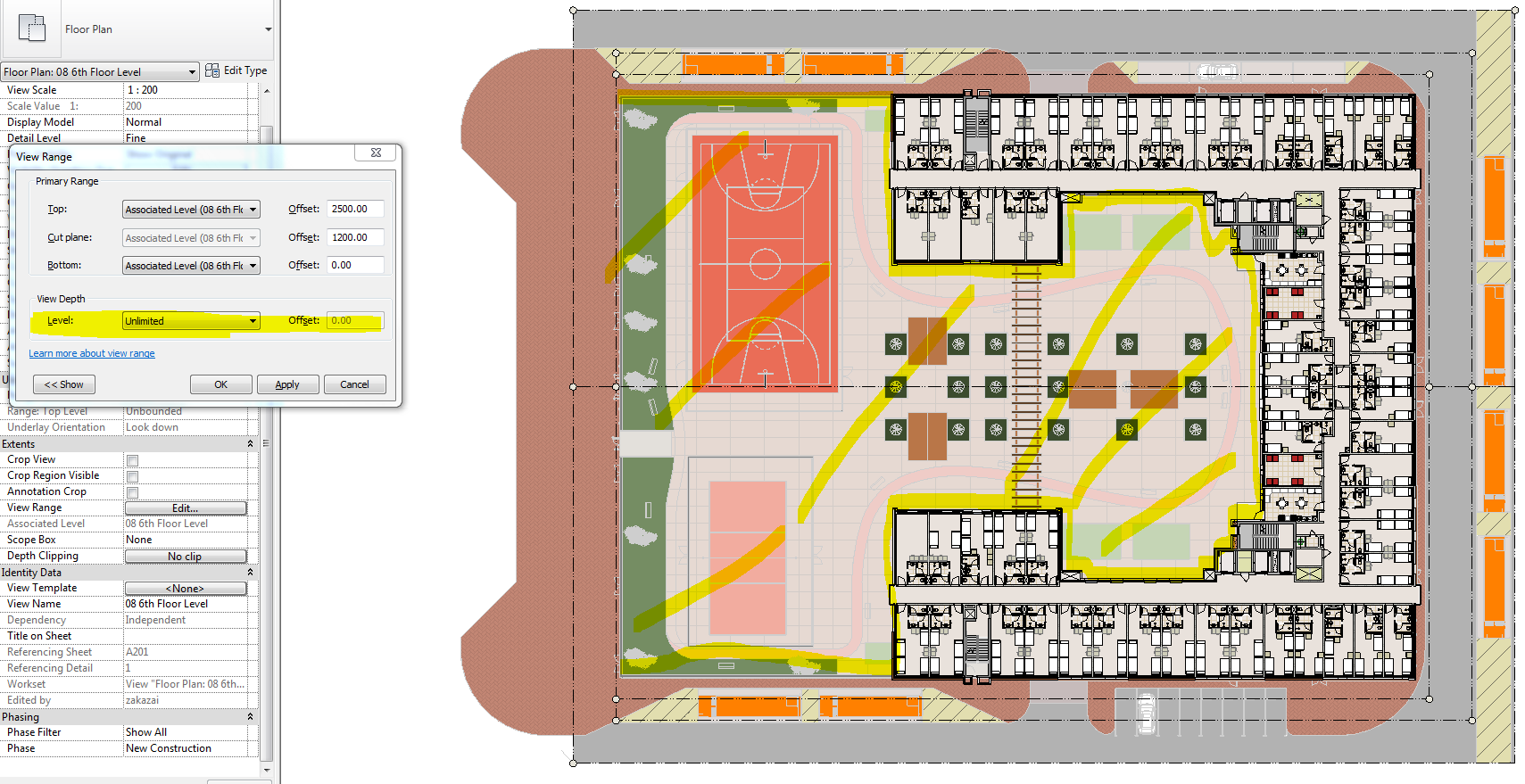

Hi
Please see the image.
I made it with view range, as plan region i cant change its visibility to light color.
now one more issue, i managed to change the line color and thickness (Beyond line).
But about color, i want all colors outside my actual plan as light(something like faded or halftone shade).
Thu, Sep 14, 2017 at 6:44:45 AM | Plan Region and View Range issue
I would not use a plan region.  I think I would use a first floor underlay.

I would also use underlay option and then linework tool for different representation. Then close the underlaying after linewrking and you have your needed lines.
