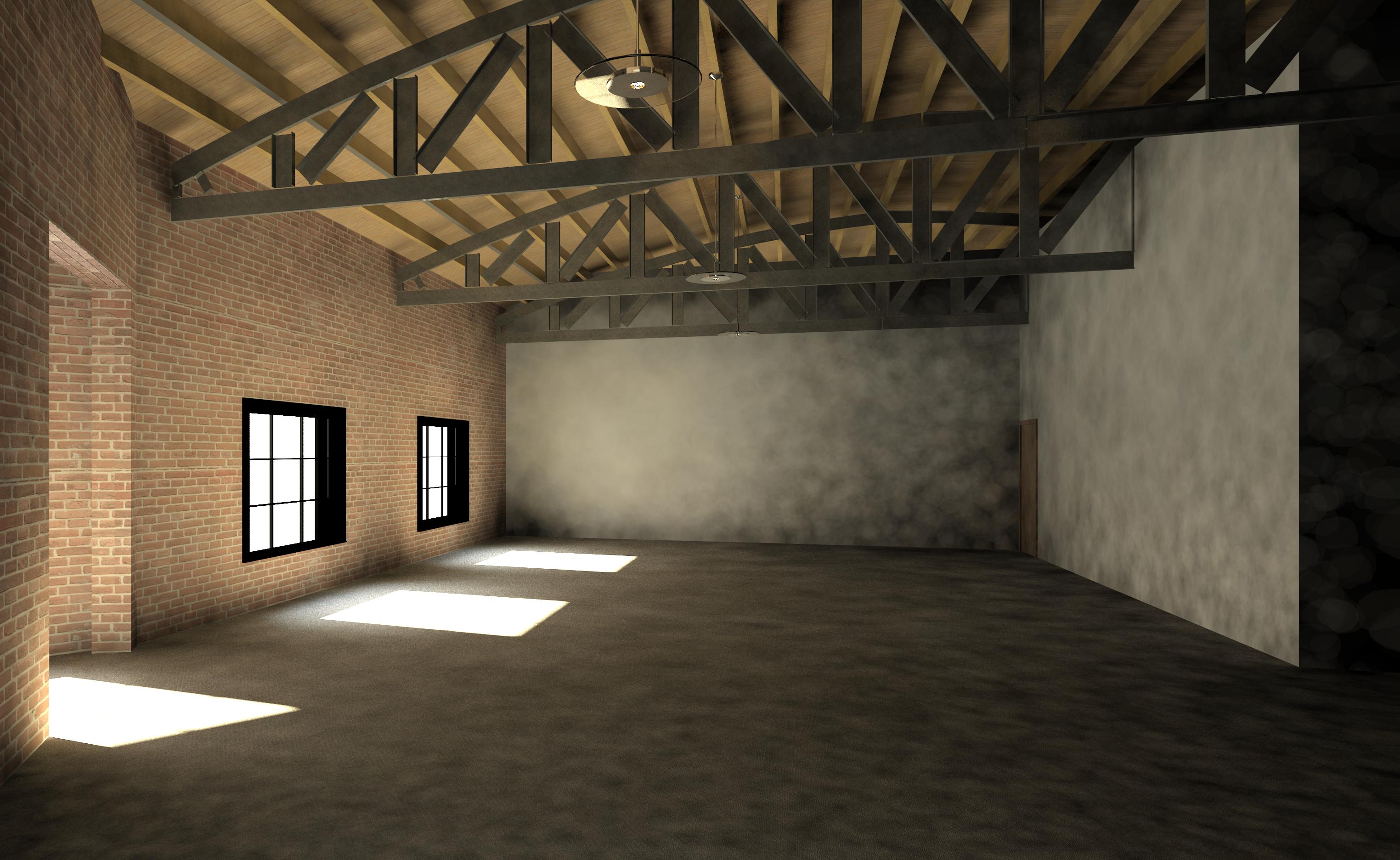

I need some help!! I am rendering in REVIT using a good resolution but I am havinf this black and white kinda of shadows everywhere....Somebody can help me please?? I don't know what else to do.
Fri, Aug 18, 2017 at 1:52:44 PM | Rendering problems
Those are not shadows on the walls, this happens with obtuse view angles and low light.  Jut like real world, you might be better off with some studio lights.

I would experiment with different custom FG settings in Revit.  You are getting diffuse ray bounces off the floor.  Take shadows down a notch too.
