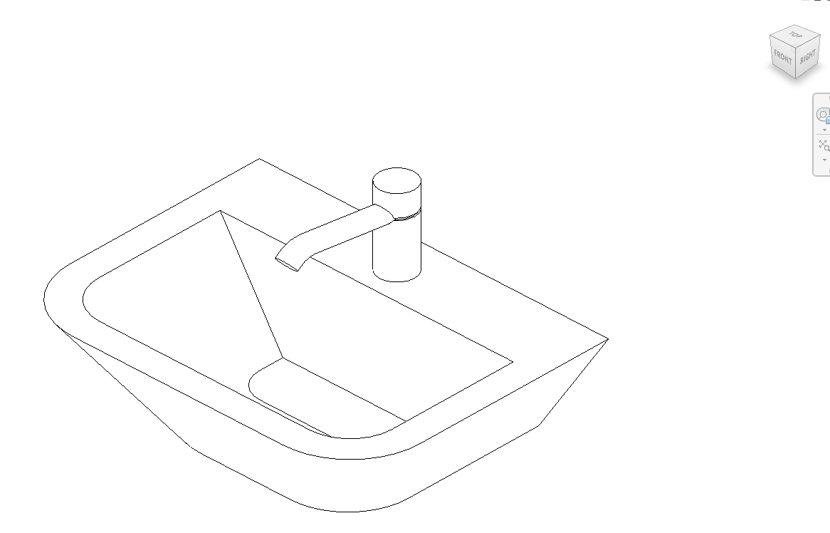

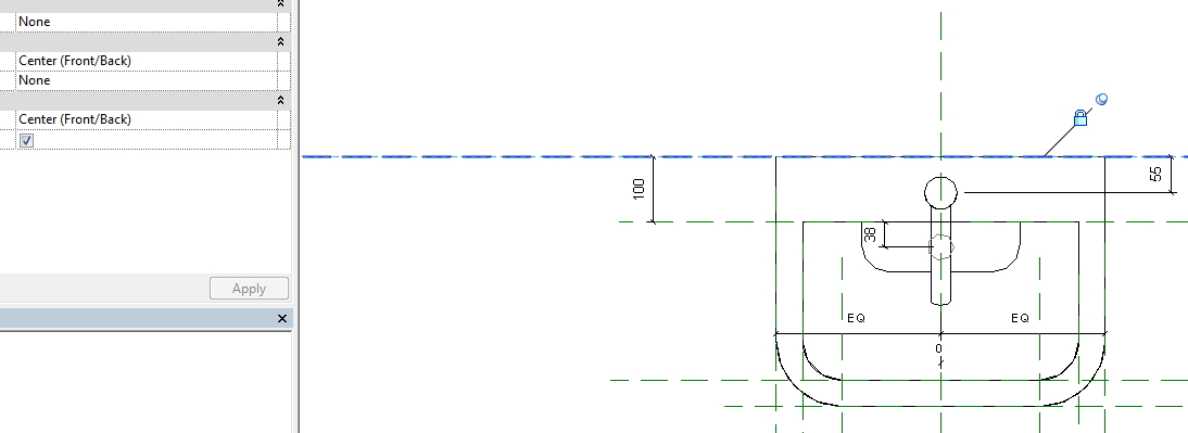

I use Revit 2017 to make a family (not wall based).
The family's referance plans look right in the family file. (please see pic 01-02)
However when it is loaded into a project, the family's front side becomes back side. (please see pic 03)
How can I fix this?
Thank you very much.

For some dumb reason, this is standard Revit.   It always displays the family in this dropdown from this view, we have been asking for a change for years.
