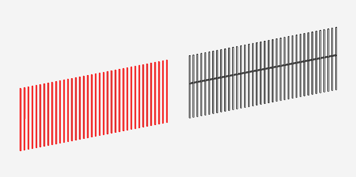

Hi
I recently encountered a problem with railings.
I need to create a railing that has baluster elements only without any railing profile. To my surprise, the railing itself becomes transparent red. I figured out that If I put a railing atleast 900mm high, it becaomes normal. However, as soon as move the railing below 900mm, it turns back to red again. I have never run into this issue before. Please help. Thanks in advance.
Btw, I am using Revit 2016.
Thu, Aug 10, 2017 at 2:06:41 AM | Railing Turns Into Transparent Red
jaiemm
Joined: Thu, May 7, 2015
0 Posts
Nevermind.
Just found out that is it due to the filter in the template that I am using that restricts railing height. Thanks.
